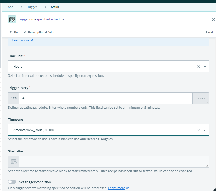

I have to schedule a recipe to run every 4 hours starting from 11 AM in Timezone America/New_York(-05:00).
I am able to provide value to run every 4 hours but I am not able to provide starting time.
Your suggestion would be greatful for me.

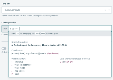

Hi Murugaraja,
You can use the custom schedule there and you can use this cron expression ( 0 11/4 * * * ) and than you can select the timezone as America/New_York(-05:00).
Thanks.

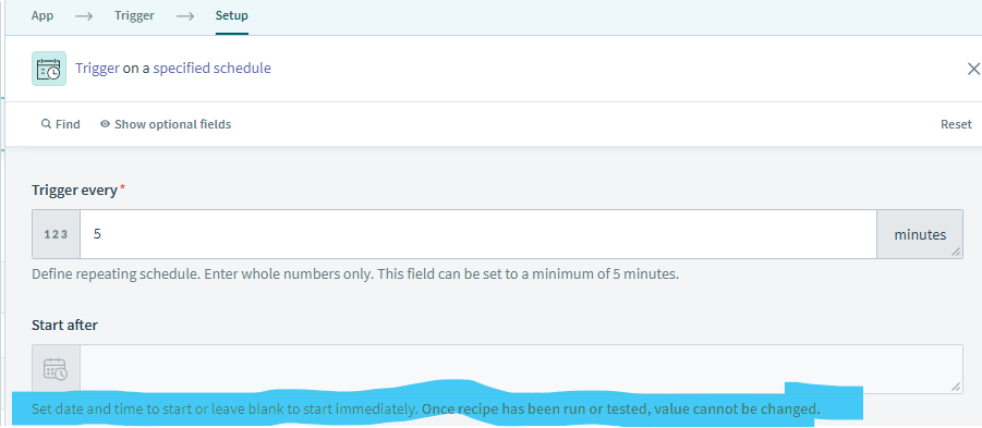

Hi @MurugarajSa ,
Following @gary1's advice, opting for that method seems more efficient than creating individual schedulers for multiple recipes.
If you insist on setting up a scheduler for your recipe and desire to establish a 'start after' time, ensure the recipe status should be 'never active'. Meaning, you cannot set a start-after field if the recipe has already executed several jobs of 'inactive' status as shown in the below pic.
To address this issue, simply make a copy of that recipe and configure the 'start after' field accordingly.

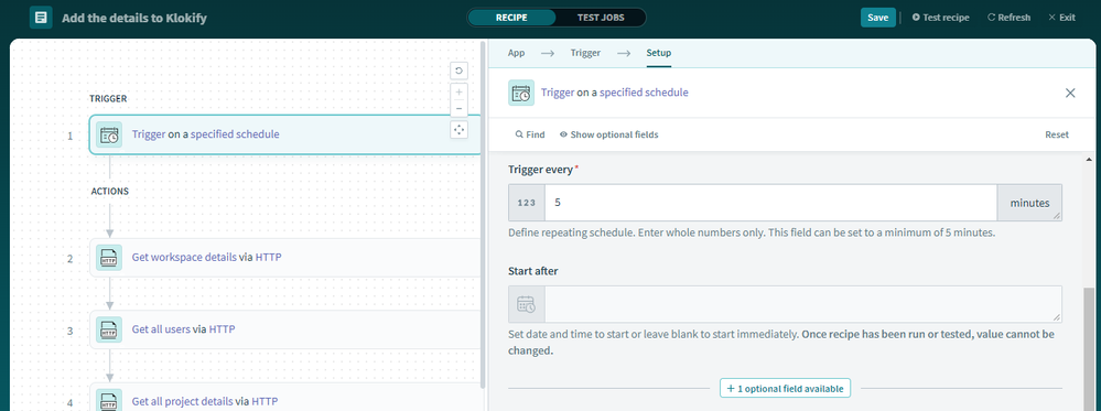

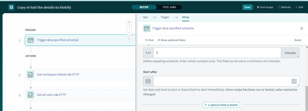

Hi @MurugarajSa ,
Once a recipe has already run, it's not possible to set a Start_after field. In such cases, one option is to clone the recipe and provide a value for the field.
Here I  Provided a screenshots which contains 1. After cloning the recipe 2. Before cloning the recipe  3. Talk about description where it states "Start_after" date cannot be set once the recipe has started. After Cloning RecipeAfter Cloning RecipeBefore Cloning RecipeBefore Cloning Recipe
