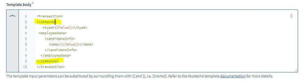

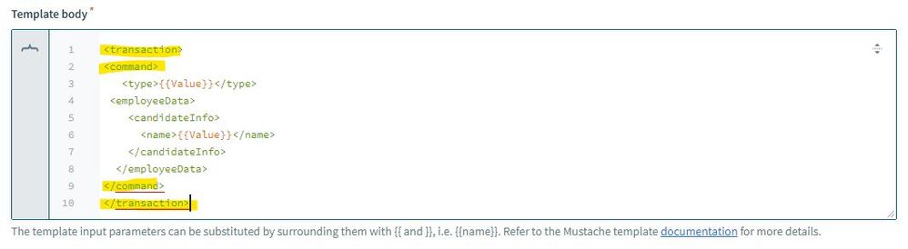

Did you know? In Workato, using <command> in an XML message template might show a red mark at the bottom. 🚩 This happens because command may be reserved keyword in Workato. ( image attached #image_1: Before fixing the issue and ##Image_: After fixing the issue)
🛠️ Quick Fix:
Add a prefix or suffix, like <commands> or <name_command>, to avoid red mark.
✅ Making this small tweak ensures smoother workflows and error-free integrations.
Stay ahead with these handy tips! 💡✨
This simple adjustment can make your XML integrations error-free and reliable. Keep this in mind for your next project! 🌟
