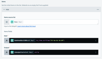

For step 8, replace "Step 5 Output" with Step 5 Message. IMO it's very rare that you will use the "Step # Output" directly. You generally want to use the data pills within the step's output.
Anyway, switching gears: let's try something different.

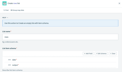

First, make a variable list:
By doing this, you now have the ability to parse and transform (clean up) the values as they go into the list:
Using to_time makes the date string a date object and then using strftime converts it back to a string using the specified formatting. Using strip on the output removes leading/trailing whitespace characters.
Now that it's cleaned up, you can pluck/to_csv and it'll be a lot closer to what you want in your email, but I still recommend using a message template! It's only a few extra steps from here.

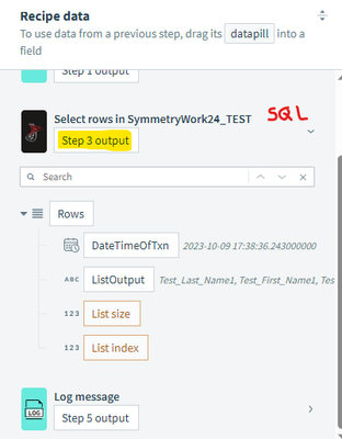

I don't know what is appending these characters _b5896cc8 , _0ec6e5e5 to the end of the column names.
datetimeoftxn_b5896cc8
Listoutput_0ec6e5e5

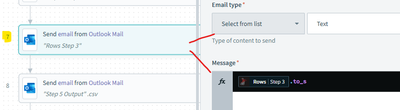

Email from Step 3 with non-data characters removed with gsub (very messy, data wraps, wrong date format)
    2023-10-09 17:38:36.243000000 ,    Smith, Joe, Front Door                                                                               ,    2023-10-09 17:38:36.243000000 ,    Jones, Mary, Back Door                                                                               ,    2023-10-09 17:42:37.770000000 ,    Bishop, Dennis, Side Door                                                                            ,    2023-10-09 17:42:37.770000000 ,    Fisher, Emily, Emergency Door
Email from Step 3 “Rows”. Contains all the “junk” characters.
[{"datetimeoftxn_b5896cc8"=>"2023-10-09 17:38:36.243000000", "listoutput_0ec6e5e5"=>"Smith, Joe, Front Door                                                                              "}, {"datetimeoftxn_b5896cc8"=>"2023-10-09 17:38:36.243000000", "listoutput_0ec6e5e5"=>"Jones, Mary, Back Door                                                                              "}, {"datetimeoftxn_b5896cc8"=>"2023-10-09 17:42:37.770000000", "listoutput_0ec6e5e5"=>"Bishop, Dennis, Side Door                                                                           "}, {"datetimeoftxn_b5896cc8"=>"2023-10-09 17:42:37.770000000", "listoutput_0ec6e5e5"=>"Fisher, Emily, Emergency Door                                                                       "}]

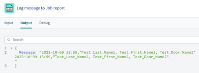

Email from CSV. Data wraps and needs formatting
{"message"=>"2023-10-09 17:38:36.243000000,\"Smith, Joe, Front Door                                                                              \"\n2023-10-09 17:38:36.243000000,\"Jones, Mary, Back Door                                                                              \"\n2023-10-09 17:42:37.770000000,\"Bishop, Dennis, Side Door                                                                           \"\n2023-10-09 17:42:37.770000000,\"Fisher, Emily, Emergency Door                                                                       \"\n"}
