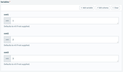

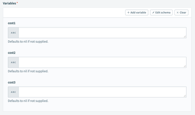

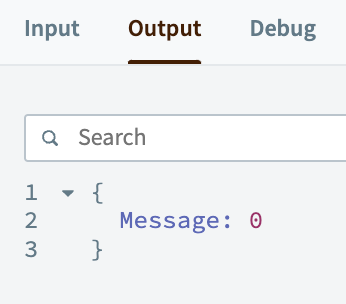

Example 1: Three string variables with null values:
Formula to add:
Formula output:

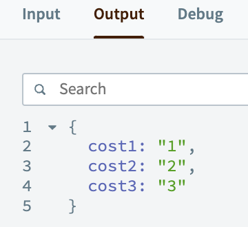

Example 2: Three string variables with actual values:
Same formula as above is used.

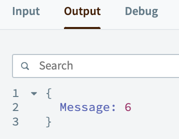

Output of the variables (strings):
Formula output:

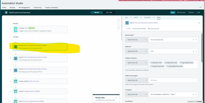

feel like I am soo close... here is my simple query to pull the fields for 1 company
and here is the creation of the variable and using thsoe fields:

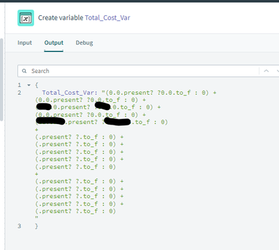

but when I test it it seems to be putting in the right costs but within a string of the formulas as shown here
โ10-02-2023 11:03 AM
You are very close ๐
You just need to click the "Formula" toggle on the upper right of the field. It's currently set to text mode.
